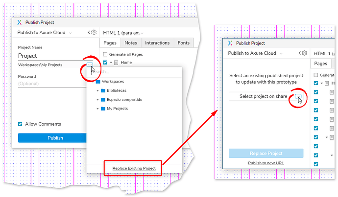

If I don’t misunderstand what you need, you can achieve it by clicking on the button to explore your folders tree on Axshare, then selecting “Replace Existing Project” and then choosing the project/URL on Axshare that you want to overwrite:

I will complain though that this workflow is pretty convoluted. When we were trying to do this originally, we had three well qualified engineers looking at the interface and nobody saw the Replace Existing Project link.
I don’t know the perfect workflow, but it seems that the rpteam file could keep track of all of the URLs it has published to and would allow you to select from a list at the top level of the interface. Then, you wouldn’t have to dive through 3-4 layers of interface to perform the replace.
