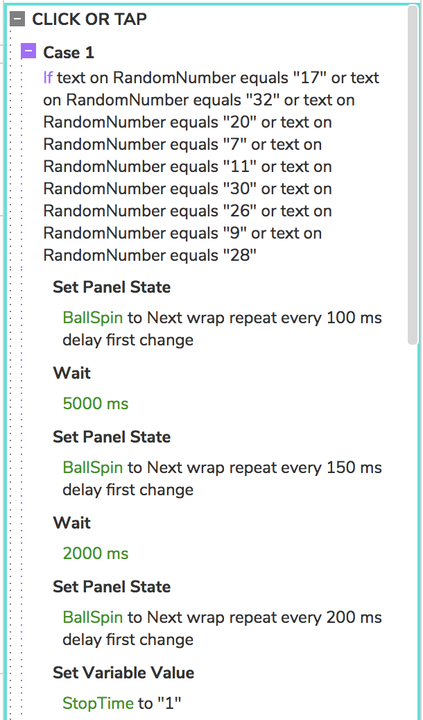

The animation for the ball’s spin is done using a dynamic panel with each state being the next number on the wheel and the animation simply setting the dynamic panel to the next state. When the ball is spun it completes two revolutions, the first at high speed and the second at a slightly slower speed. After that the ball then begins to slow down as it approaches the random number. This is accomplished by a series of actions to increase the animation time as the the ball approaches its section. The wheel is divided into four parts and the actions are timed so that depending on the quadrant the random number is in the ball will slow as it approaches that section.
Here is what the spin slow down interaction looks like:

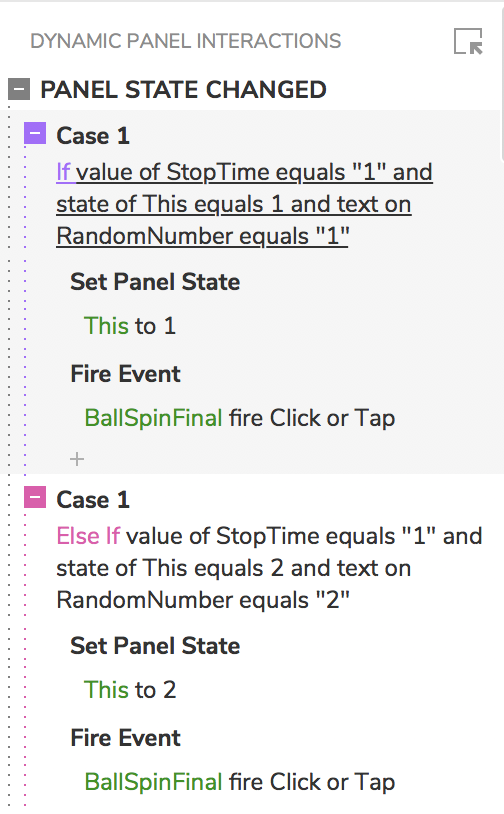

The ball stops at its final location due to an interaction on the dynamic panel that is activated once the StopTime variable is set to 1. At that point the ball will continue to spin at 200 ms while the dynamic panel checks if the panel state and the random number are the same and if that is true it stops the animation. As is shown here:
