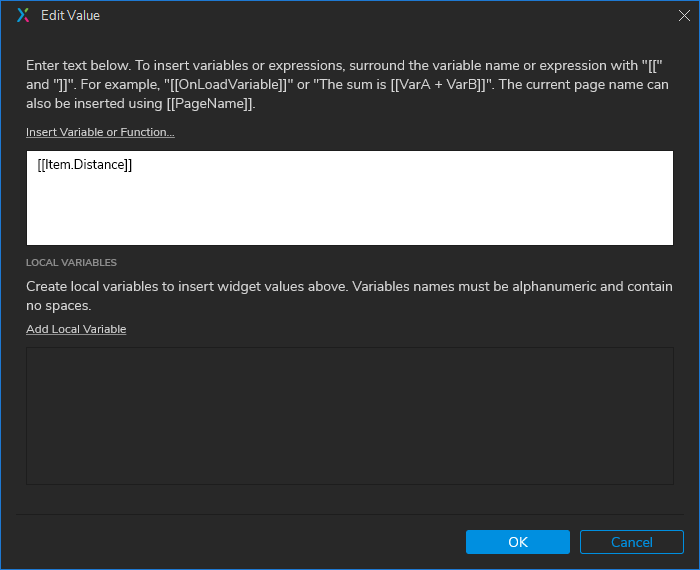

- Then I supply the Rule. In this case, I want to show only the stations which are less than 3 miles away. I can point to any of the columns in my repeater and evaluate their contents against my desired rule (technically, my rule’s “delimiter” which is 3.) I can either type in my “magic formula” directly, or click the little “fx” button to the right of the Rule field and build it with some help from Axure. This opens the Edit Value dialog:
To find out which repeater properties I can access, I click the “Insert Variable or Function…” link and spin open the Repeater section:
Aha! I can click on “item.Distance” as that is the column I want to evaluate. This fills in my Rule value:
…which i can complete by adding “< 3” inside the “expression brackets”, to get [[ Item.Distance < 3 ]] …all of which means, “the item value in column “Distance” is less than 3”, and that is my Filter Rule. If this expression is true, the repeater item (row) will be shown.
